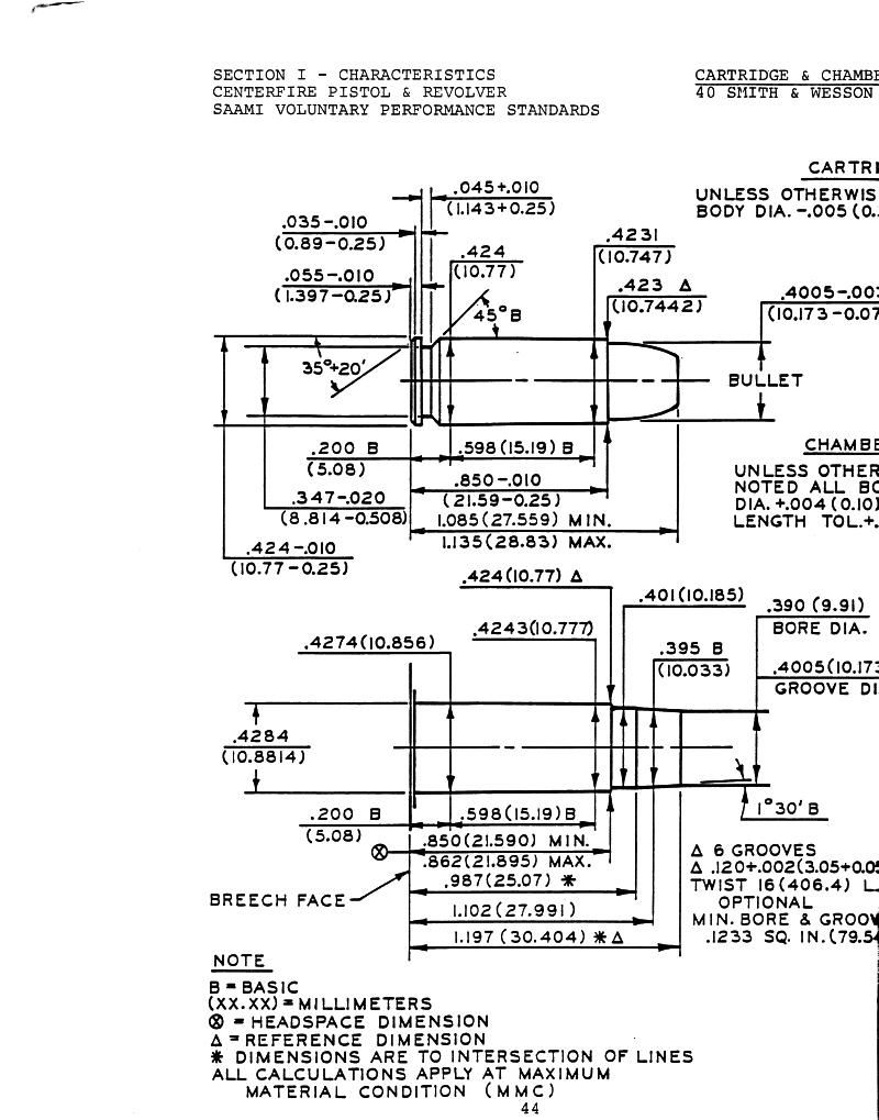

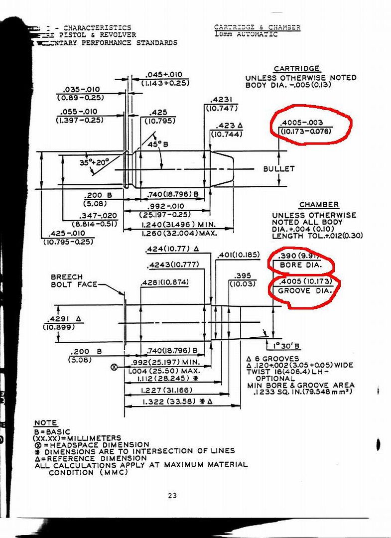

Old 07-28-2010, 03:00 AM
TheGerk TheGerk is offline
Senior Member
Join Date: Jun 2006
Location: Northern California
Age: 55
Posts: 2,475
Measure the bullets closely and check for any really odd measurements.
I would not load anything close to 0.403" or larger
As you can see from the SAAMI specifications there is some room to move in the .40
Both the .40 and the 10 maintain the same bore, groove and bullet diameter specifications. It’s the chambers that are different.
Typically what we see in jacketed is 0.400” to 0.4015” in most production jacketed
Lead and plated usually around 0.401” to 0.402”
You should be fine with your plated at 0.402, just use some reason loading up the first 10 and test
I included the scan of the 10MM only because I could not get a decent scan of the 40 cal. page data.
The pertinent bullet, bore and groove specifications are the same and highlighted in red
Good Luck
To be proficient with Firearms the endeavor must be applied similarly as in Golf or Boxing, you have to put the Rounds in! - Gerk
Gerk
